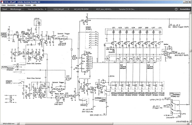

and here my 2nd schematic with 74154 (2, 4, 8 and 16 steps) - the other variant uses the 4017
(reset doesn't operate yet) I've been looking for the other step modes 3, 5, 7 etc.
in the attachment the service-manual of the Yamaha-CS-30 and the new fsm-file
cheers
TSt
cheers
TSt
- CS-30_stepseq_schematic_excerpt_1.jpg (143.14 KiB) Viewed 24811 times
testlab_8_16step_seq_clk_74193_74154_4017_dev_0.fsm- CS-30 step-seq schematic

after some times, I've got now a solution for an operating stepmode in this 8-step-sequencer
some help or explanation would be useful: to using the seq. you have to initialize the S and R input of the 4017
internal with 1 (H) and external his S with 1 and R with 0 (?), perhaps a better solution with gates or similar
components would be more practically (?)
I've been looking else for the "stop after one cycle" - mode in this seq.
at last: in Maxmsp I'm using the loadbang, loadmessage routines to intialize a Max-patcher, does these mean in FS only
numbers (int, float), variables, strings are useful?
thanks and happy maxing
TSt
TSt
8-step-seq_dev_2_TSt.fsm- (447.82 KiB) Downloaded 1094 times

thanks ROXY, so would you say that the FS 3.0.8.1 is a bit more stable as this newer version?
in the attachment my actual status of the 8-step seq - also the "stop after one cycle" mode was now solved
- but this was a little bit tricky (finished before your interesting seq-schematic was uploaded)
the newest mode "one cycle after pressed (MIDI) key" it's not finished yet, you can use this "mode"
by switching the "one cycle after pressed key"-button to on, I've test this mode with an extern MIDI-sequence
to activate one cycle mode, switch the toggle man/clk to clk
start/stop toggle is on
one cycle/repeat should be set to off
now you can activate the one cycle mode with the "one cycle" button (unfortunately I've found only this kind of button to operating with this mode - the button must be press twice, oddly enough only this button works in the schematic)
happy maxing
TSt
