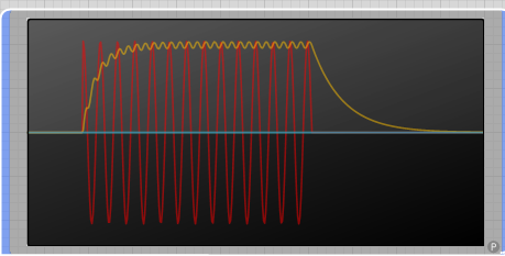

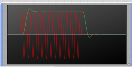

Re: K2 - Peak Compressor
Here is a pulsewith different envelope follower filters:
yellow: common single pole with different attack and release times.
green: 4-pole Butterworth filter
blue: FIR
blue: FIR

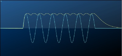

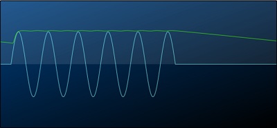

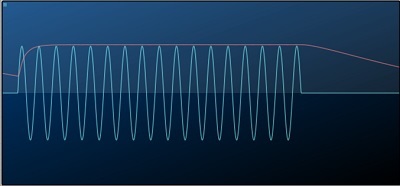

Images show a sine-wave signal which is amplitude modulted to have a 'burst' shape.
Signal shown with the 'gain signal'.
First image (gain signal in green) shows the ripples for a 100Hz signal with release = 50 ms.
Second image (gain signal in yellow) shows the ripples for a 100Hz signal with release = 5 ms. Much lower than the assumed minimum.
Third image (gain signal in red) shows the ripples for a 1000Hz signal with release = 5 ms.
From these images it seems to me that ripples are a none-issue (50ms release minimum).
Again, I'm quite new to this... Just asking.
Does this make sense to you ? Is this assumption good?
Can we say that 'first order IIR' can be used for Release greater than 50ms and signals 50Hz and higher?
Any comments are welcomed. Just learning here...
