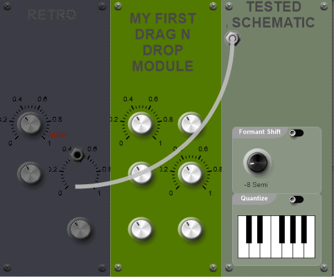

Re: Searching for everything about MODULAR RACK ENVIROMENT
The ARC module cable idea from yesterday is done! got som live into behaviour with it.
anyway right now changing order will disconect cable, lost M area and so... It only works properly if "tested schematic" is "before" in order or "after" and you never drag over it with pluged one ...but it dont break my happiness of what it becomes
the setup of cable is in top-rigt corner

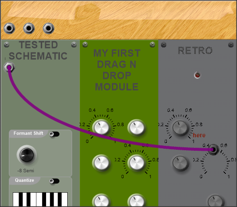

Just quick update - its free to move gui xy coordinates for cable inp. and outp - drag what you willt now, cable still![/u]
[u]
it looks like this now:
i love to use the wood in electronics
[u]
