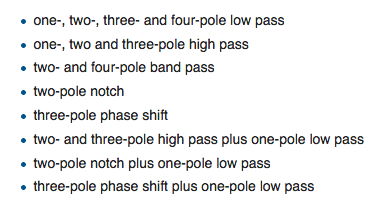

-Hello martin;
Here's the list of the Xpander's rather unusual filter states (from the Wikipedia page):
Xpander filter modes.png (37.42 KiB) Viewed 32497 times

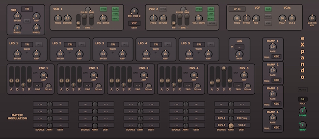

Turns out I didn't include eXpando in the Bundle, so here it is -with DAW automation compatibility.
Broadly an Oberheim Xpander emulation, but:
Filters incomplete and not very accurately emulated.
No Tracking Generators (couldn't figure out how).
Just the Voice, no splits, layers, six separate outputs etc.
https://www.dropbox.com/sh/8ymdr0rgtkvw ... Kcwga?dl=0

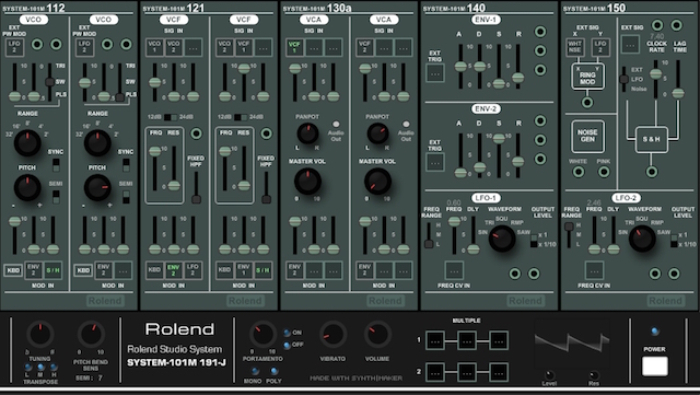

And the fix for Rolend System 101M:
https://www.dropbox.com/sh/e5p6dmccn2c9 ... kH8Ra?dl=0
Rolend System 101M copy.jpg (200.65 KiB) Viewed 32437 times
