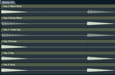

X11 re-build running great as VST and standalone
Rebuilt 90% of the whole timing system.
All 6 Seqs are 100%... Ruby Rocks!

here's the first test result:
At start
At about 5min
Give me a day or two, to test in other hosts and verify.
Will upload then.
Sorry if i gave anyone a heartattack. thanks for your patience.
