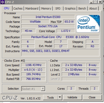

Hello TSt,
I am running Win 7, fully updated.
I have enclosed a screenshot of the cpu-z report.
It seems that I do have SSE, my guess is that the other versions would not run without it also, but they do .
Wonderful upgrade of my CS-30 schematic as well !
ROXY
- screenshot.jpg (117.38 KiB) Viewed 14930 times
