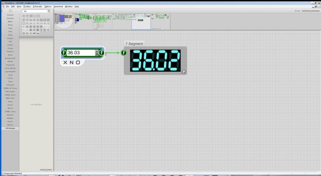

Re: Synthmaker Greatest Hits
Hello Spogg,
Nice Work,
But the Displays have Bugs,
if you set of 2 Flosatpoint digit gif a wrong digits!
In example: the F Stream bring [36.03] the display show [36.02] and so own
i has lost this Problem by change the Format block insight
Nice Work,
7-Segment_V2.fsm- Upgradet File with clean Bug
- (14.42 KiB) Downloaded 976 times
- Bug.jpg (28.4 KiB) Viewed 21595 times
