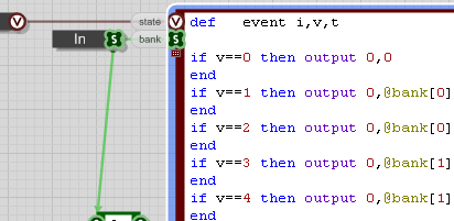

Need some 'ruby ' advice on some suspect code i got.....
This code works.
But to me, code is wrong....
I'm not telling ruby which input is "v"...
Should read 'if @state' , not 'if v'
But code works....
my question is....
should i bother changing it.....will it make a difference..???
I have about 60 of these in important positions in fsm...
EDIT:
Ok..so why does it work..??
Because @bank is used in the code...
So ruby automaticly process next available input as 'v'...??

You might need to change your 'suspect' code.
'v' is always the value of whichever input just changed - so it will work fine when the value of '@state' changes. But when the '@bank' input changes the code won't do anything because 'v' will contain the array, which can't be compared to a Integer. So you would be better off using the '@state' variable - that way, when the array changes, it will still look up the correct index.
