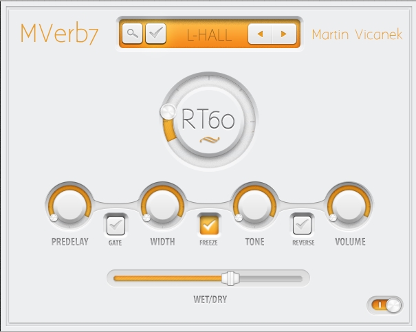

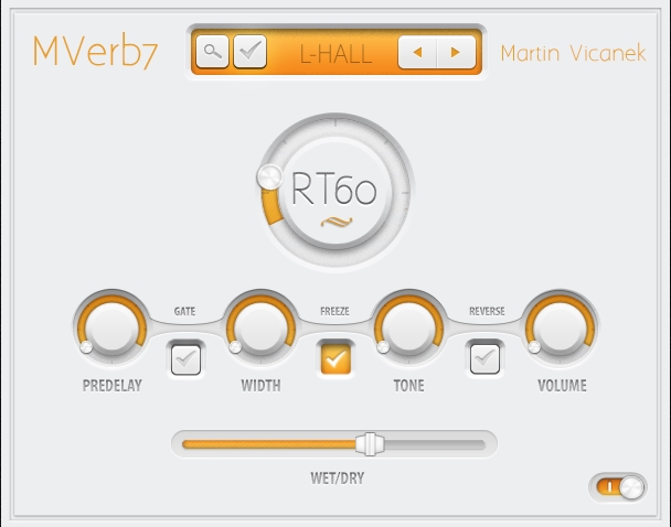

Whic ones do you guys prefer , Style 2 with fonts for the Gate , freeze and reverse on the bottom or Style 1 with thos fonts for Gate , freeze and reverse on top ?
I am unsure about on the top but dont really like them on the bottom either.
I do think it flows better on top but Just a bit unsure if its confusing from a user perpective that it belongs to the buttons ? Any thoughts?
- Style 2.jpg (88.97 KiB) Viewed 18131 times
- Stle1.jpg (88.07 KiB) Viewed 18131 times

Final version for today , been at this all day , finally got everything working.
Question though , the Tone control , how does it work , lowpass , highpass , shelf ?
I guess I could test but would like to know as I might have to animate the knob differently if its Centered as default?

Why is the Gate function a 3 state switch ?
And how does the Tone shaping work ?
I guess the pre delay numeric value is in samples at the moment ?
Also need a volume control and wet/dry.
I could make those unless you want to make them yourself Martin or Spogg ?
Also , a lot of artifacts when moving the Pre-Delay.
And quite a volume jump when i hit Freeze.
And , how many presets should be available for saving ?
