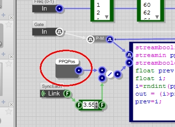

1. By convention, the MIDI song position reference is called PPQPos (or PPQNPos=Pulses Per Quarter Note Position)
and FS includes a component for that (see the image below).
2. The problem is that Ruby editor does not include a stream input accepting that signal, although it's not a downside at all.
3. We can anyway use DSP (or Assembler) component, in fact, they are more appropriate for that, and much faster processing streams. Another option is to use the "Mono To Frame" (not the "Frame Sync") primitive, but I didn't test it heavily.

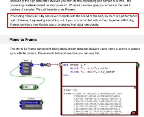

It doesn't need one. In a DAW, and in the Flowstone editor, when ASIO out is used, Ruby is always sync'd to audio. More precisely, it will always work in the current audio buffer. It should not have much issues being precise to the millisecond. I know of an arp done in Ruyb, that works precise and uses scheduled methods (methods that are executed at a specific timestamp). There's mono-to-frame to convert a specified number of samples from blue to RubyValue, this can be used to access blue data in Ruby.

I didn't find enough information and working examples about "Frame to Mono" so I was not sure it was a good solution. The concept of using a large buffer for checking a simple clock or song position seemed too slow and complicated to me, but it works.
