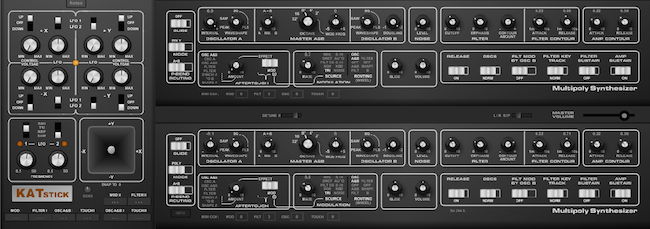

Here's a little beast of a thing - a stereo pair of Multimoog approximations coupled to my stab at the Octave CatStick.
In the course of putting this together, I also did some major revisions/corrections to Multipoly.
The Aftertouch sections can toggle to Velocity or Wheel control. The connections to the CatStick take place the same way as one would connect it to the hardware's Modulation or Touch Mod Effects jacks. Includes a Zip file with the Multimoog and CatStick manuals.

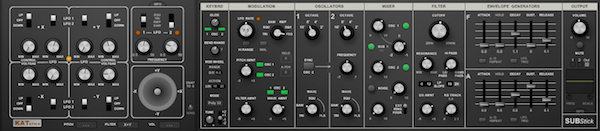

Another 'Stick-plus-Moog' thingy:

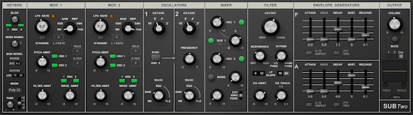

SubStick - a rather incomplete emu of the Sub Phatty, but in more traditional 'Moog-black' livery, plus a couple of functions from the Sub 37. The 'Stick adds two LFOs to Phatty's single one.
And, SubTwo - the same, but with two Modulation sections (like Sub 37), and no 'Stick.
