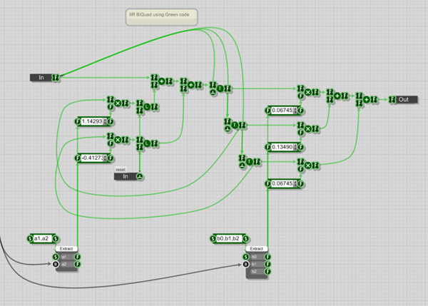

1. Unfortunately when the time-domain (IIR BiQuad) filtering is ON (I mean, the curve smoothing filter), there appears to be an issue when the analyzed signal is zero audio data. There is no issue when the IIR BiQuad output is not exploited. I assume thus that the problem is localized inside the IIR BiQuad. It looks like a denormalization issue. Such BiQuad got implemented using Green code. Can we add a denormalization protection using Green code, leaving a "non zero" audio strictly untouched, and eating a very small CPU time?
Thus, for reproducing the issue : a) set the "LPF Fb Hz " filter to 0.100 and b) double click the red - green - blue knobs in the D.U.T. control box. The problem only shows when before double clicking the red-gree-blue knobs, the CPU usage is above 40% or so. You thus need to select a quite fast timebase (say 0.10 s), and a quite long FFT (say 4096 samples) for taking more than 40% CPU usage, before zeroing the audio data. As soon as you zero the audio data, the program freezes - this is indeed a major issue. The above figures concern a Core2Duo at 1.8 GHz. If you run on a QuadCore i7, you need to select more ambitious settings like a 0.02 s timebase and/or a 32768 FFT size. When the program freezes, there is no decent escape. It is a crash. You need to quit Flowstone, and reopen the .fsm hoping the settings that caused the crash, don't get restored upon initializing. On the other hand if before zeroing the audio data you consume less then 20% CPU, you will see that just after zeroing the audio data, the system appears to continue working, in a degraded mode. Indeed, the phase curve and the impulse response curve don't appear anymore. For restoring a normal operation you need to change the FFT size, or change the IIR BiQuad "LPF Fb Hz" setting.

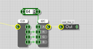

2. The centralized style is now working fine, accessible through the View property. By the way, how can I add transparency to a given colour, using Ruby code instead of Green code?

the problem with the filter is the same as the problem with the minmax. There are #IND values in the phase array, that cause that the filter can't do its calculations anymore. Just because:
I've added the fix that I gave you before in extra modules and inserted it between FFT and further calculations. I've added arrow comments, so that you can spot them. With this inplace you could remove the error correction from the Ruby code that you've added earlier, because it doing the same twice doesn't make it better.
I've also attached a schematic that shows you how to work with colors in Ruby... very simple stuff
#IND + Value = #IND
#IND - Value = #IND
#IND * Value = #IND
#IND / Value = #IND
