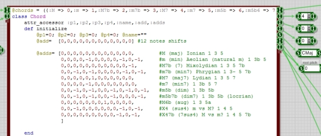

It's got 2 arp/seq modes, arp notes indexes (as common arpeggiators) and chord mode for the sequencer, which studies the scales following scale mode rules (lidian, mixolidian, ...) as you can see in the figure:
Although it's not finished yet (because I have more works in progress), I hope you will enjoy the instrument and catch the idea.
