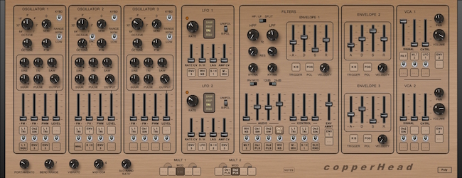

Spogg, you're hunch was correct; something polluted the toolbox. I un-installed 1.1.5, then re-named the SM folder in Appdata, re-installed 2.0.5 and all is fine, except of course, empty toolbox. Whatever got in there must have been by mistake, I haven't put anything new in it for a week or two and this just started happening yesterday. I'm wondering - can the toolbox get too full, or have too many complex modules? If it's just a single troublesome item in there how on earth do I identify it? I guess just read through the list and see if there's something who's name doesn't make sense?
Anyway, no big tragedy - what I was working on was going to be my swansong anyway. A mashup of functions from ARP 2500, 2600, Odyssey, the CMS 2607 and a couple of ideas from Macbeth's 2600-inspired M5. All wrapped up in my favorite new GUI, the copper panel with 'Bakelite' knobs. Calling it copperHead.
