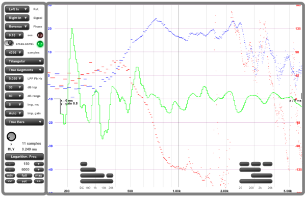

Thank you again MyCo and DWB. After removing the 25 Hz forced redraw I'm perfectly happy. Like DWB wrote, most of the time one can set the timebase to 0.200 s or 0.100 s with FFT lengths equal to 2048 or 4096, knowing that 8192 is also possible on fast PCs. For special cases one can select a slower timebase like 0.500 s coupled to a 16384 or 32768 FFT length. I have a thin doubt about the 65536 FFT length.
Attached is the update.
The .zip contains a full-screen standalone .exe.
Thanks, again
Steph

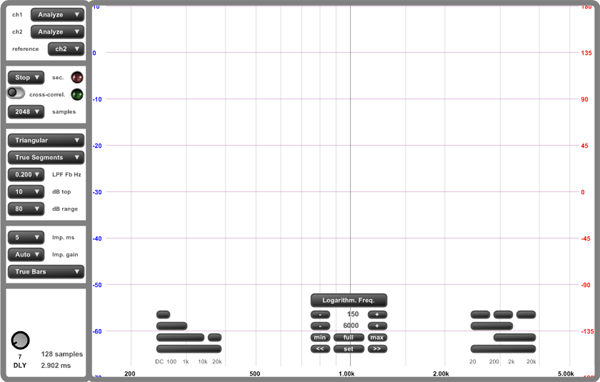

Here is a proposal for combining the FFT-based Audio Analyzer and FFT-based Spectrum Meter in one single program.
- It presents as a two-channel FFT-based Spectrum-Meter
- However, one of the two channels gets assigned as reference
- This enables to implement a FFT-based Audio Analyzer on any of the two channels
With the curves colour scheme that's currently in place, there is no way to tell if a curve is from ch1 or ch2. Both magnitudes are blue, both phases are red, and both impulse responses are green.
An alternate curves colour scheme is required. Playing with alpha (transparency) for altering ch2 colours perhaps?

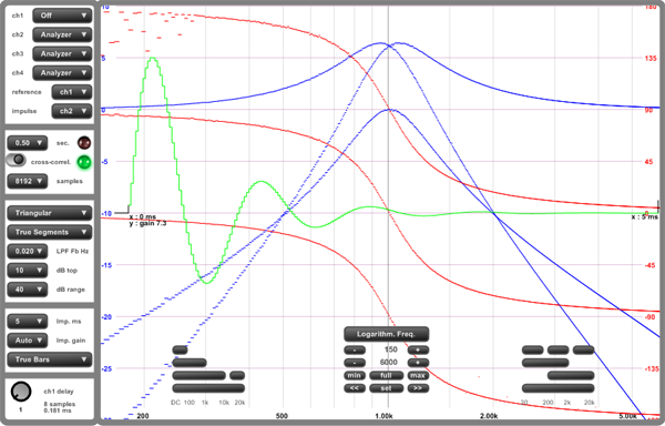

So, here is the FFT-based Spectrum Meter and Audio Analyzer.
This is a four channels instrument. It displays the spectrum magnitudes (blue curves) of four different audio channels, simultaneously.
One channel can be defined as reference channel. The preferred one is channel 1, featuring a variable delay compensation. Up to three audio channels get simultaneously analysed (magnitude in blue, phase in red) basing on the common reference channel. There is a cross-correlator hooked on channel 1 and channel 2, estimating the delay of channel 2 relative to channel 1.
The impulse response (green curve) of one of the three analyzed channels can be graphed. Actually the impulse response of the reference channel can be also graphed (relative to the reference channel), of course this leads to a Dirac pulse.
If you setup all channels as "Spectrum", no reference, and no impulse response, the instrument is easy to use.
Things get a little bit more complicated when configuring one or more channels as "Analyzer". In such case you absolutely need to define a proper reference channel, usually channel 1. This implies that channel 2 and following are connected to the signals you want to analyze.
The impulse response is only available for the channels that got configured as "Analyzer".
Don't be fooled by unerased memory effects like the instrument displaying an impulse response for a channel that got not configured as "Analyzer". I need to improve this, clearing the data and/or issuing a warning. This is in the todo list.
There is no protection against CPU overload. In case the CPU gets overloaded by a long FFT size and/or a fast timebase, the program will freeze. Can Flowstone read the CPU percentage like from the Windows task manager?
Now that the Spectrum Meter modality got implemented, there will be important information showing at the bottom of the graph, like the distortion rays peaks and the noise floor. Unfortunately the Frequency Control surfaces are also at the bottom of the graph. Can Flowstone show/hide the Frequency Control surfaces, using a button? How to program this, in as simple way?
@DWB : the rendering lowpass filter is now 1st order IIR (instead of 2nd order IIR), with special control override concerning the coefficients. This enables implementing a "no filter" configuration, without relying on a dedicated multiplexer/selector.
@MyCo = the Ring Bus that's deployed for F Bus (frequency control) is tricky. Most of the time if you disconnect and reconnect the ring, it doesn't work anymore. One need to be very careful, connecting a F-pad before another F-pad, also connecting the "listener" (the MainView) at a certain stage. Only a few combinations work. Most combinations don't work. When it doesn't work, the Log pad and the Lin pad still control the frequency parameters - you see them changing in the detailed F-pad - unfortunately the "listener" (the mainView) doesn't grab the changes. How to improve this? Is there a connecting sequence to be observed on the Ring Bus?
Cheers,
Steph
