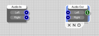

Postby Perfect Human Interface » Mon Sep 22, 2014 4:57 am
As far as I know there's no "Stream Out" primitive in the FL version of Flowstone. Is that different in the non-FL version?

Postby tulamide » Mon Sep 22, 2014 2:04 pm
Perfect Human Interface wrote:As far as I know there's no "Stream Out" primitive in the FL version of Flowstone. Is that different in the non-FL version?
tulamide wrote:You mean the module does not provide two mono outputs? If that's the case you're right. It should have two mono outputs to work correctly.
As you can see, I was referring to the outputs of the module.
A module needs to have two of the mono outs as in my image above, but none of the ones from your image to successfully work. So, if you indeed meant 'audio out', then all I explained in a post further above is true.
