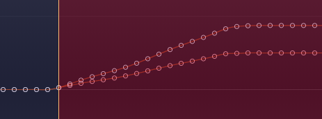

I re-tested in FL. It's always drifting, and the drift is not consistant.
This is the closest it gets on my CPU, sometimes it's 2 to 3 times this distance away from the mark.
Note:
this "reading" is with Timer delay Compensation set to 0, and host delay Compensation un-touched.
Tried lots of different combinations here, both on timer and host, and the above settings giving me the
best result you see above

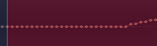

Seems that all the recent testing I've done was a trip to nowhere.
Have been repeatedly testing the X11 2.0 update.
All the time, it's like this...
Don't forget this timer(like all the ones I've posted)
relies on the X11 Automation System for PPQ Accuracy.
Which means if your building a VST, my timers are next to useless for your needs.
