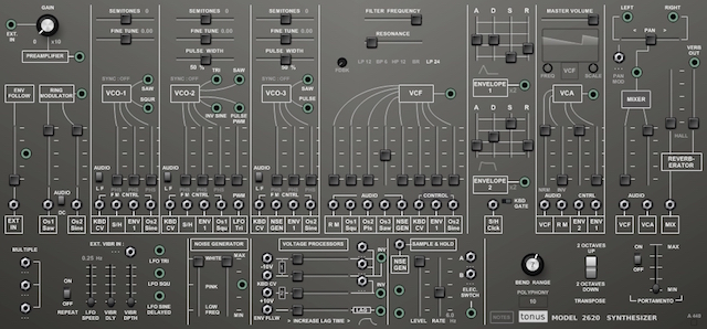

A couple of initial observations about the Tonus 2620 (in case anyone's working on these).
- VSTHost appears to be saving and loading .fxp patches without issue. But unlike the other synths I've tried (so far!) in this bundle, the 2620 only has the one slot - so patches can't be collected into .fxb banks. If it's an 'easy' fix (I know! I know!) .fxb export would be appreciated.
- The spring type reverb isn't attenuated by the sliders.
- The oscillators track the keyboard even in LFO mode: I don't think the original hardware did (though I could be wrong - it's been a while!). With the addition of the 3620's LFO, this probably isn't much of a limitation - might even be considered an enhanced feature in may cases - but maybe something to be aware of.

Tonus 2620 reverb fixed - total oversight on my part.
I set up the keyboard track to be on or off as you wish. The 2600 automatically turned off the keyboard when you switched to LF mode (the Odyssey, also). Since keytrack of 'LFO' rate is sometimes wanted, I implemented the keytrack as on or off at will - the far left CV input 'KBD' can be turned on or off by clicking on it's jack. I know it's not strict emulation, but I liked having this option easily available.

k brown wrote:Tonus 2620 reverb fixed
Thank you!
(Could have sworn you said something about having other things you wanted to be doing ...)
k brown wrote:I set up the keyboard track to be on or off as you wish. The 2600 automatically turned off the keyboard when you switched to LF mode (the Odyssey, also). Since keytrack of 'LFO' rate is sometimes wanted, I implemented the keytrack as on or off at will - the far left CV input 'KBD' can be turned on or off by clicking on it's jack. I know it's not strict emulation, but I liked having this option easily available.
Very elegant!
