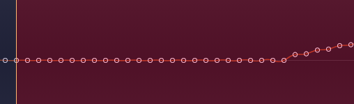

Ok, screwed my head back on and took another look at what your doing......
First test, and it's like this at every (song jump) marker...
Great work mate
And even better is that the test unit was thrown together really really quick,
the circuit looking back on it, is rough as guts. So, yeh, a good sign for your ticker

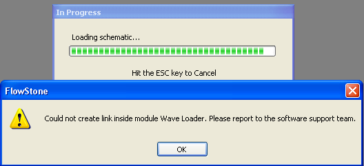

I got issues here....couldn't open FSM.....locked up CPU, force re-start...???????

Old SM Wave player module creating a problem . . .
Updated here, you should export to vst to check it out.

Drnkhobo wrote:Updated here
Cheers mate, thanks for that. File opened + saved..all good.
