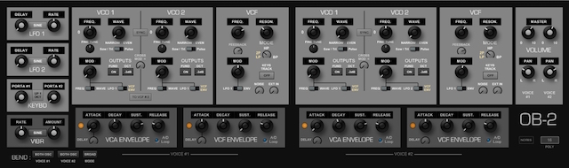

I did an update to OB-2 with enhanced envelopes; they are now exponential and have delay and A/D Loop (when either of these is used the EGs are linear).
More importantly, I gave all the controls unique Preset names - let me know if this makes the Presets work in a DAW, or if more needs to be done.

Just tried it out in Tracktion - saves and loads presets AOK. But maybe Tracktion is just functioning the same way vstHost/SAVIhost does?

They have names now in Reaper, seems like it is fixed by your changes :D
Anyway, there are still some unnamed parameters in the list but they don't seem to have a function:
http://i383.photobucket.com/albums/oo27 ... cr7oni.png
If the demo of FS is fully functional, and you can explain how to edit the defaultnames with the correct ones, I am still willing to help.
