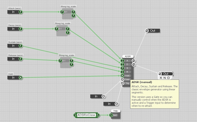

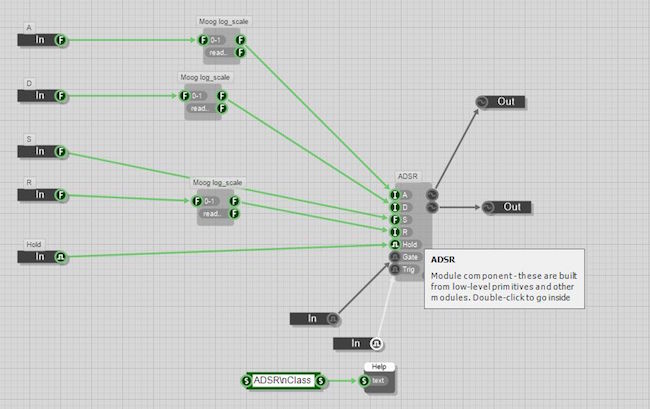

Spogg wrote:
k brown wrote:On an unrelated matter, I'm probably the last person on the planet to realize that the old EG prim that had a trig input (ADSR4?) doesn't show up in FS4. I just discovered none of my synths that have LFO trig and AD loop that used that prim no longer have those functions working. Is there a current FS4-friendly EG that can be triggered by the LFO and cycle the AD stages (act like an LFO)?
Short answer is I don’t know. :oops:
Longer answer is that I recommend uploading a demo schematic to Discord to the Help section to show what’s not now working. One important philosophy is that anything made in FS3 should work properly in FS4, so this is important!
I don't remember how to get on/use Discord (never use it), so I'll just post the screenshots, if they're of any use.
I remembered wrong, it's the 'ADSR (manual)' prim not the 'ADSR4' prim that's getting auto-replaced by the module shown, when schem is opened in FS4.
The attachment Orig.jpg is no longer available
Which looks like this inside:
In FS4.jpg (48.05 KiB) Viewed 14831 times
As you can see my beloved little 'Trig' input has nowhere to go! ; - (
I'd been using the Trig input to do LFO triggering, and the 'Stage' (lower) output of the prim to do 'AD Repeat' (cycling) function.
