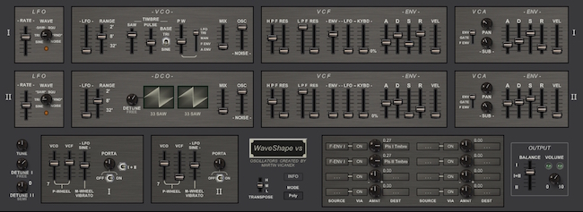

This began life as an approximation of the Roland SH-101, but with two independent synth-lines. I called it Juan, Oh Juan (because I'm a big corn-ball) - can't remember if I posted about it here.
I changed the SH-101 style oscs to ones that can switch between the 'WaveShape' oscs (with every parameter modulatable) and a dual set of the Propher VS wave tables (which can be mixed to any degree, and one can be detuned to the other).
Tons of flexibility with many controls' alternate modes; any that have hyphens on either side of their labels can select other options by clicking on them (for example, each LFO target can select either whatever wave the LFO is set to, or any of it's other waveforms).
Of course, I can't leave FM out of the picture, so that can be done with the WaveShape oscs via the mod matrix.
I also gave it one of my favorite filter setups, HP > LP with common modulations (CS-80 style).
The two synth lines have independent Porta, and Wheel (SH-101 style) controls.
Only a handful of presets so far, but thought I'd throw it out there for the curious.
