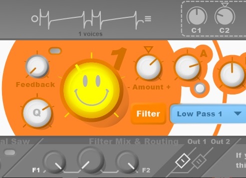

Hmmm. I recognize that shape
Not nearly as sweet sounding and also somewhat transitory in my synth though...
I am not using the waveshape osc at all... but instead one of his other osc's, so I guess I have a ghost in my newbie synth. MV is haunting my synth.
Spooky action at a distance I think Albert called it?
It might be the hundreds and hundreds of hoping dezippers of his
