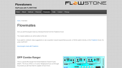

Ok, so LA Bands is now available on flowstoners.com !
Get the VST HERE
Thanks again to Spogg, who made the hosting available. I'll try to make sure that all of My final plugs are available for download in My Signature. They'll all be hosted on flowstoners.com of course.
