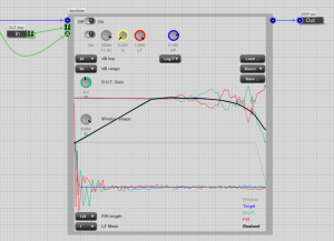

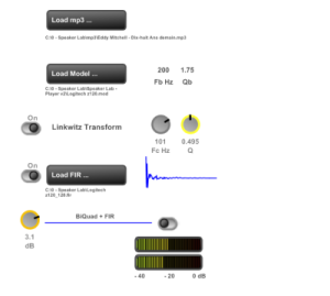

Let's begin with the Speaker Lab Player. This is a simple .mp3 player featuring :
- BiQuad IIR filter
- FIR filter
- A/B switch
- VU-meters
Currently, I'm using Logitech z120 speakers. For reproducing the experiment, you need those speakers. They are widely available, and inexpensive. This is the only required hardware for running the Speaker Lab Player.
The BiQuad IIR filter serves as Linkwitz Transform, compensating the low frequency resonance and deep bass 2nd order high-pass attenuation of the closed-box speaker. In case you don't know what's a Linkwitz Transform, please check section 9 here http://www.linkwitzlab.com/filters.htm
The FIR filter serves as linearizer above 300 Hz or so.
The dB knobs are there for equalizing the listening levels.
The A/B switch enables you to compare the unprocessed sound against the processed sound.
The VU-meters are there for showing if you get close to digital saturation.

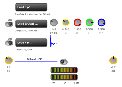

Here are a few z120 BiQuad filters you can select as Linkwitz-Transform.
Unzip the file in the directory where you have the .fsm.
Select one of those BiQuads upon pressing the Load BiQuad ... button.
The BiQuad labelled as MODEL is not to be used as Linkwitz Transform.
Such file is there, only for documentary purpose.
This is the BiQuad modelling the z120 resonance and low frequency roll-off.
Here are a few z120 FIR filters you can select as linearizers above 300 Hz.
Select one of those FIRs upon pressing the Load FIR ... button.
Would be nice if you could share your listening impressions.

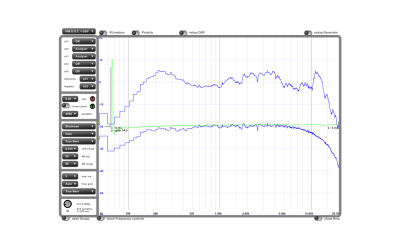

Here are the z120 frequency responses, uncorrected (above) and corrected by the BiQuad + FIR (below)
The green plot is the impulse response, when corrected.

Attached are the control screens, visualizing the various impulse responses and correction needed.
- green curves : genuine, uncorrected Logitech z120
- blue curve : target, obtained from stage 1
- red curves : corrections required from stage 5, actually there are two sets or red curves, the non-windowed correction, and the windowed correction.
- black curve : corrected Logitech z120.
Now you are watching, what you just listened at.
You know where the FIR filters are coming from, and how they got designed.
Remember this is the design stage.
When listening to the music, the above scheme is of course not executed. The only thing that gets executed when listening to the music, is the resulting 256-tap FIR filter, the one that you select using the "Load FIR ..." button in the Speaker Lab Player.

- FIR design - Target 2nd order lowpass Q 0.707 (300).png (24.4 KiB) Viewed 59275 times
- FIR design - Target 1st order lowpass (300).png (23.06 KiB) Viewed 59275 times

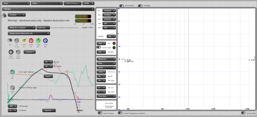

Want to experiment the Speaker Lab - Designer ?
Here is the corresponding .fsm
Speaker Lab - Designer.fsm- (635.19 KiB) Downloaded 1664 times
- FIR design - impulse - FFT & compare - iFFT (500).png (88.38 KiB) Viewed 59274 times

Re: Speaker Lab
This is Player v2.
- Speaker Lab - Player v2.png (18.67 KiB) Viewed 59154 times
Speaker Lab - Player v2.zip- (837 Bytes) Downloaded 1690 times
Speaker Lab - Player v2.fsm- (30.33 KiB) Downloaded 1675 times

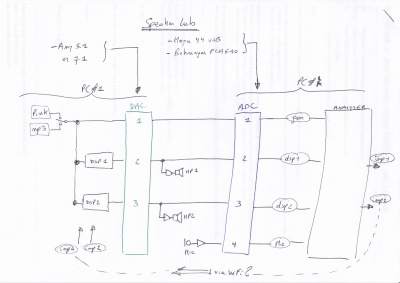

Re: Speaker Lab
Client/Server Speaker Lab, running on two separate computers.
The advantage : both x86 PCs can have relaxed specifications.
The disadvantage : need to setup the corresponding TCP/UDP Flowstone blocks ...
p.s.
As the DC doesn't get conveyed through the reference channel, one need to be careful with the first frequency bin.
A possibility is to rely on the Client -> Server data link for conveying the missing piece, however the Client -> Server latency will cause trouble, and even more trouble will be caused by the USB+DAC+ADC+USB latency. The DC bin arriving through the Client -> Server link won't correspond to the actual audio data, sampled by the ADC and sent to the Analyzer using USB.
p.s.
