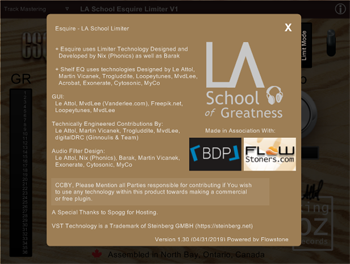

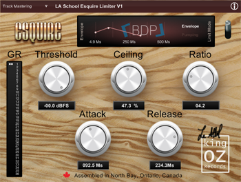

Hi all, worked late into the night making this beast. It's not a Beta; But a working example to learn from. I plan on making a final version and I think there could be some optimizing.
max 3% CPU, I believe it could go down to 1.8?
Here are the images (click for full):
EDIT: New version 1.3 posted.

Hi all, so I have updated this limiter so that it now has a slightly nicer design (more memorable) and it uses less CPU.
Here is a link to the KVR post (click image below):
It sounds a bit nicer now, a bit like the bands 2 EQ; I avoid using the attack for bassy kick drum samples though. I'll be adding an optional HP for such dilemmas.
