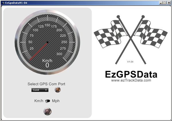

Here's my latest fun project, a GPS data logger and analyzer for motor sport!
Using the GPS Mouse supported by FlowStone I have made a race car data logging app that automatically records your gps position 10 times a second, this also has a real-time speedo. This data is saved to a file once you come to a stop:

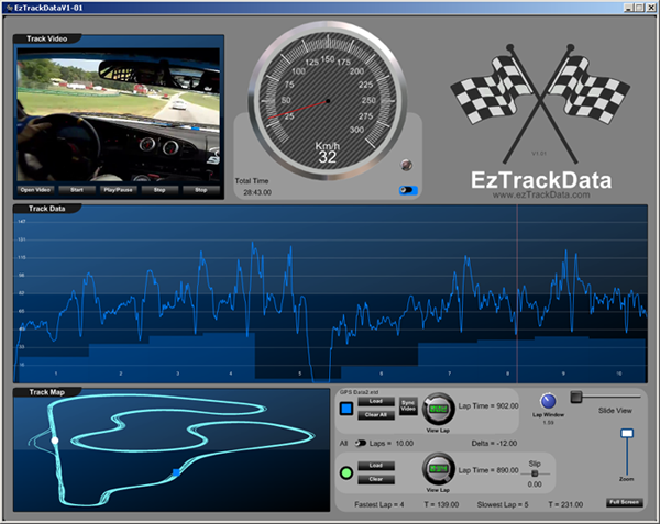

You can then open the GPS data file in the lap analyzer app. This displays speed vs time, plus draws a map of your circuit etc. It will also auto detect laps so you can compare them side by side to see why one was faster than the other. To top it off you can load and sync a video of the race to see your exact line for each corner etc.

I have no commercial plans, it was just a fun project for personal use that sort of got out of hand.
What is great is, having a proper project to work on I have learned a lot about FlowStone, especially screen redraws and how to optimise them. The hardest was the speedo, with all of the little lines, the solution was to use FlowStone to render it as a bit map, and use that.
