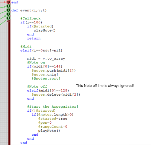

I don't yet know much about Ruby but I did experiment a lot with the code.
The #note off line in Ruby is always ignored even though I've checked that the note-off MIDI is coming in correctly.
Even if I put illegal code in the line it's still ignored. How can this be?
I'd love to understand what's wrong here.

Everything after a "#" until the end of the line will be ignored by the interpreter.
These are comments and they are only there to improve the readability of the code for humans.

Sorry, it's the 2 lines under the # comment that are ignored and I can't see why.

There's two ways, externals send a midi off. The one according to the midi specification is 128 (note off with reported velocity at key release). That's looked for here.
Some manufacturers take another path and simply send 144 with velocity 0. This is not a specification, so if you have an external that sends this, it won't be recognized by the arp.
You can try if it is the case here by changing the following code:
if(midi[0]==144)
@notes.push(midi[2])
@notes.uniq!
into this
if(midi[0]==144)
if midi[3] == 0
@notes.delete(midi[2])
else
@notes.uniq!
end

Part 2 now confuses me. I had a look at the appendix of the 61es manual. It says to support Velocity Note On (which is 144) but not Velocity Note Off (which is 128), so I wouldn't expect it to send 128 on note off. And if it works now with the addition it indeed sends 144 with velocity 0.
The question has to be answered with yes, I'm afraidSpogg wrote:Does this mean that my mark 1 M-Audio Keystation 61es is a POS for not being standard? Thing is, I checked and the keyboard is sending 128 so I'm confused.
Stuck notes are pretty much normal. They can occur for many reasons (for example, your system doing an update, bringing all other threads to a halt until finished). It isn't related to the midi implementation, nor the keyboard itself.Spogg wrote:Plus, very occasionally in my Quilcom projects I get a stuck note. Now I'm wondering if it's the MIDI implementation on the keyboard that's not ideal.
No, it is just an addition that also takes care of those sending 144 with velocity 0. 128 still is supported. I can't force my controller keyboard to play at 0 velocity, human fingers just can't, even at the finest velocity curve. Also, most DAWs restrict the velocity range to 1-127 anyway (to support those controllers sending 0 velocity as note off). So there shouldn't be any issue.Spogg wrote:Also, does your modification preclude some other keyboards from working correctly?

Spogg wrote:Does this mean that my mark 1 M-Audio Keystation 61es is a POS for not being standard? Thing is, I checked and the keyboard is sending 128 so I'm confused.tulamide wrote:The question has to be answered with yes, I'm afraidPart 2 now confuses me. I had a look at the appendix of the 61es manual. It says to support Velocity Note On (which is 144) but not Velocity Note Off (which is 128), so I wouldn't expect it to send 128 on note off. And if it works now with the addition it indeed sends 144 with velocity 0.
I just downloaded MIDI OX and checked and you are (of course) correct. I can't recall how I came to believe it was sending 128 but it's not, for sure. It sends 144 with velocity 0, just as you say. So, sorry for the confusion!
