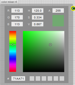

Sooner or later we all come to the point where the color prim just isn't sufficient, because it lacks an alpha channel. That's where all of us do our own solutions (mostly a module placed behind the color output, to add an alpha channel).
I think it might be better to have a generic color mixer that all of us can use - and improve. Kind of like a community project, where everyone adds whatever seems helpful and re-uploads here.

Color Mixer r4 (22/June/2015)
Download reanabled here on the forums.

New version. See first post to download.
color mixer r2 features RGB, HSV (new) and alpha. Values get immediatly updated for the other color model, so you see the changes in realtime.
Still 100% Ruby!
Usage: Click on a box and drag to change a value. Hold shift while dragging to finetune. Double click to enter a value. Use ctrl-c and ctrl-v after double click to copy/paste.

New version r3!
See first post for image, changelog and to download. Comments very welcome.
