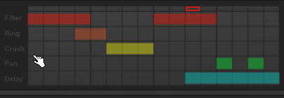

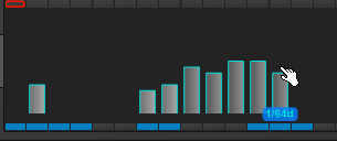

you can modify my stepsequencer for this, it has already all the sync stuff you need
viewtopic.php?f=3&t=1001
i did this kind of things in reapeat x, there are various ways to do it but its always the same scheme, store values (on/off - selections - parametervalues...) in an array and iterate through it in whatever speed you want...
