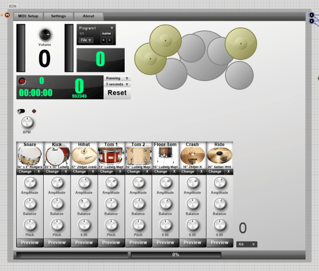

Using
Assuming you installed correctly, just load up the .fsm file in FlowStone (I only have an old version, but I assume newer versions will work), load a .kit file using the [Kit] button, then click the big red INIT trigger button to start loading all the samples. You'll see a progress bar in the statusbar.
Configuring
The default MIDI mapping is setup for my cheap-ass Medeli dd505(D) digital drum kit. You can change the MIDI bindings using the menu buttons on the top-left. Just smash your drum kit to select the matching key, then click the event you want to map to it.

Poly limit (part of drumpad player) - A mechanism which tries to approximate perceptible amplitude of a single channel, then kills the least perceptible channel if there are too many active channels.
Windowing system - Open, close, drag and z-order multiple windows inside the user interface (I may have published this earlier; can't remember).
Drumpad player - Variable velocity layers, pitch ending, balancing, etc. This thing is pretty flexible and fast.
Drumpad UI - Flash when you use a drumpad.
Mixers UI - Managing the configuration files and samples.

It's "nearly complete" as in "it does everything a digital drum kit synth should do", not as in "ready for commercial release". The most obvious omission is an initial loader for the kit and drums and lack of organisation in the UI. Neither should be particularly difficult to fix. As far as the audio processing goes, I consider this finished. I've done some experiments with binaural stereo a while back, and would like to add it (since it works quite well), but simply don't have the time to get around to doing it. Also, I seem to have lost my experiments.
It's good enough for me to use regularly next to BFD3 and ToonTracks.
