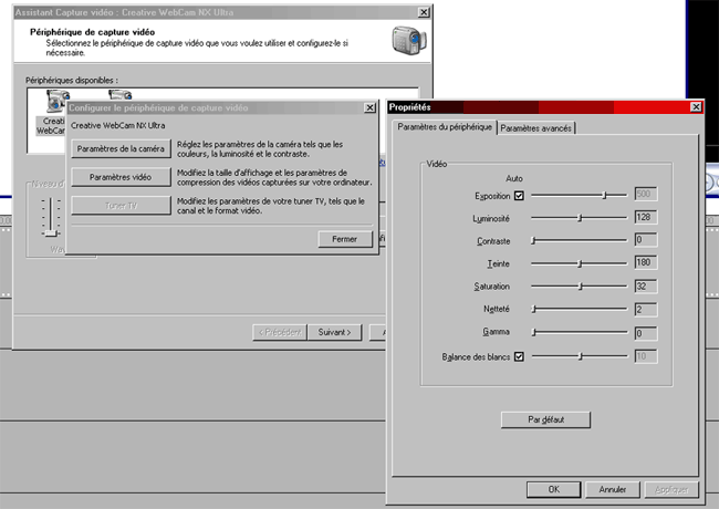

Hey all,
I'm trying to build a webcam software and I stumble over how to call the webcam property page from FlowStone.
It seems to be possible to get it as it's a feature available in any webcam software outthere...
From what I understood it looks like a windows librairy has to be invoked: the WIA librairy...
It sounds like a bit complicated to me...
Sure as Win Movie Maker is basically installed on any windows machine, there's still this way to go thru to set the
webcam configuration, but, sure it's not that convenient...
Any one has any idea on how to do that? Or should I just give up?
This property page

OK, after deep investigations,this look like a real nightmare to me...
Been thru hundreds of pages on the internet, and couldn't find something... :?
But I found out that when using 2 webcam components at the same time, The WIA source tab comes up to select a new device not already in use...
So I guess the webcam component is somewhat linked to the MS WIA librairy...
So my question is, would it be possible to add to the FS webcam component, the page properties( which are filter pin and format pin if I understood correctly) of the selected device used by the webcam component ???

I investigated a bit more....
That's the one! I think... :?
HKLM\SYSTEM\ControlSet001\Control\DeviceClasses\{65E8773D-8F56-11D0-A3B9-00A0C9223196}\##?#USB#VID_041E&PID_401D#6&22991E56&0&3#{65e8773d-8f56-11d0-a3b9-00a0c9223196}\#GLOBAL\Device Parameters
How Can I open/run this in FS?
Should be doable no?

Postby tektoog » Thu May 05, 2016 6:03 pm
Does anyone know what is the correct syntax to input this expression as a correct argument in the FS Shell component?
it should be something like:
RUN ::{HKLM\SYSTEM\ControlSet001\Control\DeviceClasses\{65E8773D-8F56-11D0-A3B9-00A0C9223196}\\\?\USB\VID_041E&PID_401D\{65e8773d-8f56-11d0-a3b9-00a0c9223196}\\GLOBAL\Device Parameters}
I wonder
- does the shell primitive read # characters?
- do I have to replace empty spaces with % symbols?
- Should the path be HKLM\SYSTEM\ControlSet001\Control\DeviceClasses\{CLSID}\GLOBAL\Device Parameters
or HKLM\SYSTEM\ControlSet001\Control\DeviceClasses\GLOBAL\Device Parameters\{CLSID}
- Also is the RUN command able to load this kind of keys? otherwise which one should I use?
- Another thing, is this argument calling associated DLLs at the same time? Then that would be another story... :(
I've spent almost a week looking for infos and didn't get anywhere...
