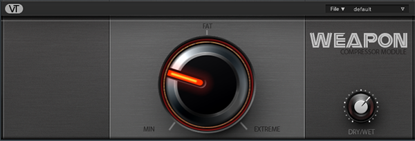

After the test, I noticed that in Fl studio is a delay after its inclusion in the chain. I added a delay compensation module and tried to draw a GUI.
You did not try to pick up an extra set ratio relations with the attack?
To be able to choose from three or four options, because the maximum value very much starts to bulge "tail" in the audio signal. for example in the notorious sound goodizer))
Thanks
fsm here https://yadi.sk/d/6-xCqOyKzjrTk

- weapon gui.PNG (191.65 KiB) Viewed 21291 times

Hi StereoSpace
That's a really nice looking GUI you've created; brilliant!
You've made a really good point about the audio delay for the look-ahead function. When I was tuning this I'm afraid I didn't do it within a DAW so I was just listening to various sources to get the best compromise settings, mainly for various final mixes.
The design for this was just intended to make stuff sound louder without the usual knobs and controls so I think a fixed Delay Compensation would be useful.
Thanks for this.
Thanks for this.
