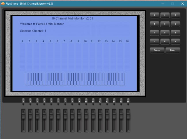

This is my first post here.
I'am new to flowstone and ruby.
I want to make a Midi-Monitor and later a controller of it.
This is wat i made till now.
Maybe some of jou have some tips?
Midi Channel Monitor v2.31.fsm- (86.8 KiB) Downloaded 1171 times
- Midi Channel Monitor v2.3 screenshot
- screen.jpg (86.44 KiB) Viewed 31530 times

Hi PatieThePC and welcome to the forum
This is really good, it works fine with my M-Audio Keystation 61es and I put it straight into my toolbox so thank you very much for sharing.
I renamed the keys in the Ruby module from D#, G#, A# to Eb, Ab, Bb because I'm used to that naming system.
I don't know what you had in mind originally but it might be nice to have a bar graph display for CC values; maybe a dedicated one for pitchbend and modwheel and one where you can select the CC for less common ones like aftertouch etc. Just a thought and I like it as it is!

Spogg wrote:I renamed the keys in the Ruby module from D#, G#, A# to Eb, Ab, Bb because I'm used to that naming system.
Caution, Mr Wisenheimer speaks: Both of you would be wrong. You see, there is a difference between D sharp and E flat. You might not notice it, since we are used to play on equal tempered piano replicas. But, for example, on a violin it may be a noticable difference.
When to use sharp, and when to use flat? Whenever you're ascending it's a sharp, when descending a flat.
Ascending or descending from what? From the key you're in and the chord you're in (chord progression). Basically, from the root.
But for midi there is no key, it is just naming the pre-defined midi note-numbers. Yes, and no. There is a root. Midi defines (and only defines) middle C as midi note number 60. Regarding that, it would be sharps all the way up from 61 to 127, and flats all the way down from 59 to 0.

Tnx for the info Spogg and Tulamide,
I was thinking about that ptoblem. One sulution maybe is "Let ruby remember last note and than calculate if the note go's up or down" But i'am beginner in ruby, so it wil take a while for me to figure that out.

A made a little progress on the Monitor. Now all 16 Channels are readout, and i put the ruby-code for each channel in to one ruby_module.
Now i want to try put the greens for the level_meters togeter in one mudule, maybe in ruby also.
More functions comming soon.
My goal is to make a complete Midi-Monitor/Controller of it.
New version in first-post
Damn fine work for a "beginner" I'd say!
One problem I can see is what do you display if it's the 1st note played and it's a Bb (A#)?
Another is what if the key changes?
Also I might be confused if the naming changed as I played.
One possible addition would be a switch to select note name or MIDI note number...

I'm afraid I added more confusion than I helped. The notation does not change during play!
If you're just interested in displaying the note name equivalent to the midi number than it is sharps above midi key 60 and flats below midi key 60.
58 = Bb
59 = B
60 = C
61 = C#
This wouldn't change ever.
If you want to show the note names depending on the key of the song (don't confuse this with the midi key), you can only force the user to set one up.
58 = Bb
59 = B
60 = C
61 = C#

I've made some changes to my midi Monitor/Controller
The level sliders are working now.
I have changed the playing notes to be displayd in a piano. You can chance the display channel by
clicking on the channel-number.
Most work was at the inside. But more functions are comming sone.
Hope jou like ik. Tips are welcome
