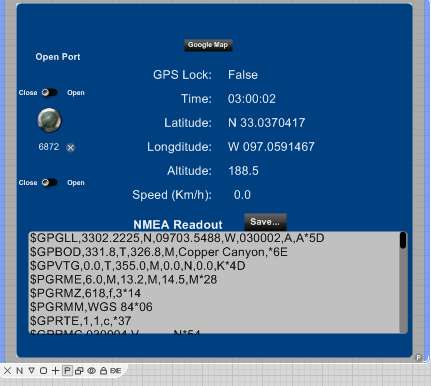

However, I only have an old Garmin eTrex Legend handheld GPS unit with serial connector cable. I tried modifying the LS20031 GPS Module V3 to work with my Garmin, but it did not seem to work. Upon doing some research I found that the NMEA format output may vary between GPS models. I set the GPS to output NMEA at 4800 baud, then used the COM Port Tester (here viewtopic.php?f=3&t=220#p555) to make sure the GPS was communicating. After communication was established, I then used Hyperterminal to connect to the GPS to capture a text file of the NMEA output. From there I was able to modify the COM Port Tester fsm with components from the LS20031 GPS Module V3.
The image below shows what I have so far. You can see the NMEA stream output once the GPS is connected and you can save the output as a text file. following the steps above, you should be able to configure it for any GPS capable to output NMEA.
I still need to set up an array/buffer and a counter to make sure and capture all of the NMEA output so one could customize information output.

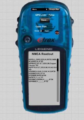

A new version of the GPS Tool. I realized that I had to add a "-" to the longitude for it to map correctly. Also added a new GUI that uses the tabbed window template from the SynthMaker wiki page and image of an actual Garmin GPS and I was able to save some GUI space while creating a pleasing and more realistic GUI. The "Menu" toggles between item 1 which is the parameters readout of the GPS and item 2 which is the NMEA readout. I could keep adding windows for other parameters as well. Things I still want to do: create a side momentary button like the actual ones on a Garmin GPS and add the array counter so that the entire NMEA sentence readout is captured.

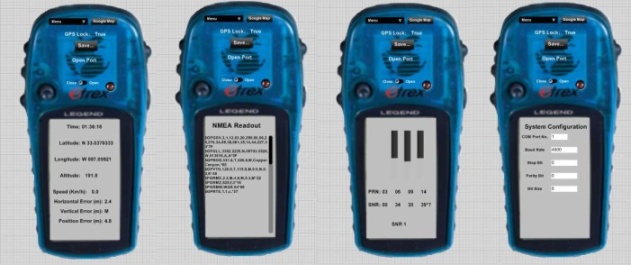

Here is where I am on this project: added a system configuration window to allow changing the COM Port setting and added satellite PRN number and signal to noise ratio (SNR) windows.
Things I am still working on:
1) an auto logging of the NMEA output - need to be able to determine the number of lines in the text box so that when it reaches a max number, it auto saves the output. However, I tried using the string array with the lines out but either I do not know how to use it properly or I am missing something, it only gives a number of "1" and nothing else when the Garmin GPS is connected and communicating.
2) a background such as rectangle behind the image of the Garmin front panel. Is it me or is the move forward/backward feature missing? I tried to find it everywhere by checking the Flowstone menues, right clicking on the modules, etc. Maybe I have to be more careful how the MGUI is layered in the fsm file. Guess I will keep working on it.
3) trying to make the SNR bars drawn go up not down. I used the draw bar module from the Step LFO but maybe I don't have it set up correctly. Also Tried to set up a string hold trigger so the SNR and PRN would stay present until updated, but did not work.
Other things that could be done - preset configurations and outputs for different models of GPS (Garmin, Magellan, etc.), windows for waypoints, etc.

Hi acg,
Coming along nicely - it's looking very smart now.
Here's a couple of suggestions for you...
Number of Lines.
As you already have the number of log entries available at the central string array, I'm guessing that what you really want to do is to find out when the amount of text overflows the view area for the "screen" - i.e. so that it takes into account the wrapping of long lines.
You should be able to do this using the "String Measure" primitive. The area that you feed into this primitive would be the actual screen area of the display (so that it knows the width of the view for wrapping). The output area is then the actual area occupied by the text - the 'screen' is full when this height matches or exceeds the height of the viewport. This should be more reliable that using a count of the array entries as it will account for the indeterminate length of each individual line.
You may need a second array to make this work though - without using Ruby, there is no way to append text to the end of a file, and the most recent "block" will overwrite the current file contents - so you'd need to save the contents of a separate array that holds the entire content for the session.
I'm doing a lot of Ruby fiddling about at the moment - if I get a nice "text file append" module working, I'll post it up for you. I think that this would be a more appropriate solution, as it would be able to simply append each line as it is received without requiring any kind of bulk storage within the schematic (other than for the display lines).
Screen Layers
The reason that you can't change the layer order is because those layers are hard-wired into the MGUI using solid links. When you do this, the order of making the links determines the order, and the GUI "back/front" options get disabled. So there are two possible fixes...
- Change the order of the links by removing them, and then rebuilding - the link that you make first ends up being the bottom layer; last link made is the top layer.
- Change the "daughter" GUI modules so that they communicate with the MGUI using wireless links. Wireless receivers that link to a common view transmitter have no pre-determined order ,so the layer ordering menus will become active again. This is probably the best way to do it, as it preserves the graphical layer editing in case you decide to add or remove anything later - and you have the necessary view transmitter there already.
