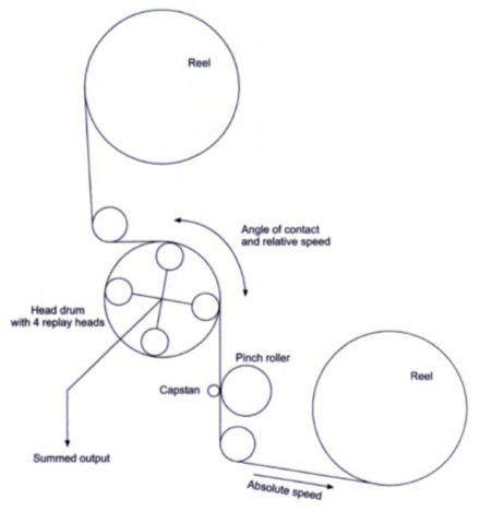

Here is another gadget suggested by BobF:
The apparatus is briefly described in the DAFX book and is known as the Springer machine aka Laufzeitregler or Zeitdehner. Today we can use ring buffers instead of tape and vary parameters in a wider range. The result can be anything from a 4-tap pitched echo to a comb filter with a pitch shift. Quite vintage, but cool, if you fancy such stuff.
P.S. Below is also a code version (easier to read but higher CPU hit).
Zeitdehner_code.fsm- (137.69 KiB) Downloaded 1268 times
