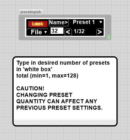

This modified version of the Preset Manager has an additional
text entry box (white box) for assigning the total number of presets.
Font size is increased for easier viewing.
Layout is rearranged and easy to modify.
Download includes the schematic file presetmgrefx.fsm and
the toolbox mod presetmgrefx.hom
Download Link:
https://www.inventorefx.com/_ifxfstone/presetmgr.zip

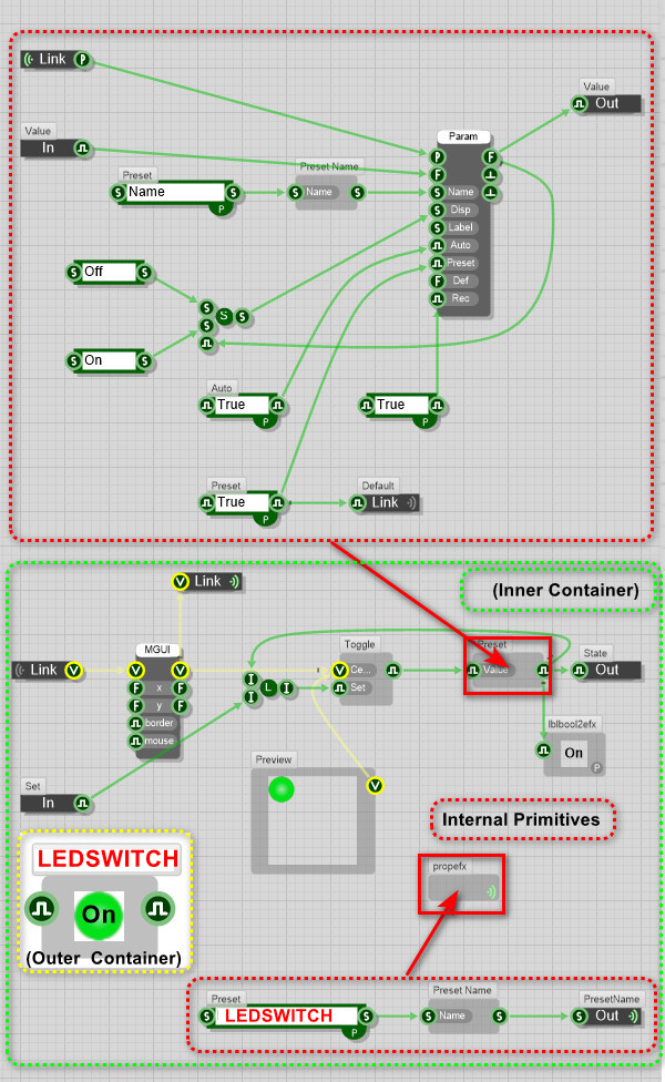

Image Preview Preset LED Button Switch Primitives:
https://www.inventorefx.com/_ifxfstone/presetledsw.jpg

Interesting idea to give the user the option of extending the number of presets.
Is the input box limited to 128 which I understand is the limit for VST specification?
