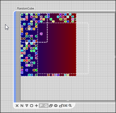

Finally i try a new way. With the prim Redraw Area.
Could even better do a manual resize of the redraw.
Here's we only have one gradient and one filled rect that change color.
But the redraw only reveal some part of that change.

Here's a way to make it sort of "not redraw" when there's another windows on top.
But i don't know if there's more cpu/memory use like this.
A bitmap is created on load and store the result.
When an "unwanted redraw" is call the bitmap is draw.
I don't know how works the bitmap create prims.
Maybe it's just a reference of the view, maybe it's like redrawing all the view or draw to a bitmap ?
I try it with LMMS and Darkwave Studio 32bit.
(The module need some optimization. Random color could be simpler and the bitmap size is done badly)
Random Graphic3B.fsm- (11.37 KiB) Downloaded 1341 times

I think you have to understand that you are using some cheat or trick in FS, and what you see is actually not there. You must do some 1 per sec. tick or one pre 10 sec. tick to make the rectangles still there, you have only two modules - that means only two rectangles fill the area 25x times per sec. at around 1% of whole area. So I suggest 100 would fill it all the time you set on ticker.
According to: reading unconsciousness and so... Actually some visuals can "close" the perception of it - changing the times, layers, and dimesions or random algo. helps subject to stay focused on. Its boring to watch only squares that changes colours so my interest slip away from that.
I just changed the dimensions and times and multiplies the rectangles. It dont fill the area anyway 100%
