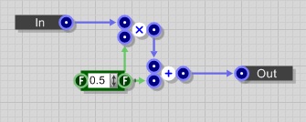

Its a little more optimized like that. you need less variables.
- bias.jpg (15.91 KiB) Viewed 25502 times

adamszabo wrote:Its a little more optimized like that. you need less variables.
Why do I need Fewer variables ?
rocknrollkat - Posts: 213
Re: D.C. corrected Oscillator pack
Because it reduces file size, and it reduces ram. Also if you want to write that in assembly it saves CPU, which means it uses less electricity so we can save more trees
- adamszabo
- Posts: 667
adamszabo wrote:Because it reduces file size, and it reduces ram. Also if you want to write that in assembly it saves CPU, which means it uses less electricity so we can save more trees
Yeah, and it also reduces your OPTIONS.
By locking up your C.V.s to fixed values, you defeat the whole purpose of Synthesis.
If you're building a black box generator, fine, but otherwise, see my next schematic, ROXY's Corrected L.F.O.-2.
Also, bear in mind that depending on C.P.U. architecture, having separate values in separate registers may actually speed up performance by allowing two accumulators to access two different memory locations simultaneously.
Always supply file size, C.P.U. performance data and RAM allocation with your claims, otherwise it's just speculation.

But arent we programming here? We are not building electronic circuits with voltages this is all digital: 1 and 0. So this is programming, and in programming you usually find a solution to a problem then you optimize it as much as possible. Your goal was to make a bipolar signal into unipolar. That was the goal, and I just helped to optimize it. In assembly the code would look like this:
But if we remove the '1' variable and we achieve the same thing with jut 0.5 you get less lines of code and you can save the xmm2 memory address from being occupied
This is a very crucial way to optimize and save cpu.
float F1 = 1.0;
float F0P5 = 0.5;
movaps xmm0, in;
movaps xmm1, F1; //we move the value 1 into the xmm1 register
movaps xmm2, F0P5; //we move the value 0.5 into the xmm2 register
addps xmm0, xmm1; //we add 1 to the input
mulps xmm0, xmm2; //we multiply it by 0.5
movaps out, xmm0;
float F0P5 = 0.5;
movaps xmm0, in;
movaps xmm1,F0P5; //we move the value 0.5 into the xmm1 register
mulps xmm0, xmm1; //we multiply it by 0.5
addps xmm0, xmm1; //we add 0.5 to it
movaps out, xmm0;

[quote="adamszabo"]But arent we programming here?
No, YOU are programming here, or so you say.
I'm creating working modules that can be lashed together into working synthesizers.
I searched your posts, lots of talk, no schematics.
I've already pointed out that minimizing variables can create more problems than it solves.
I posted a schematic demonstrating WHY I leave variables accessible.
And if saving a line of code makes that much difference, either your project is too big or your computer is too slow.
I'll sacrifice one line of code to have more musical flexibility.
That's what the code is there for, to create projects that work, NOT how compact we can make a block of code.
ROXY
