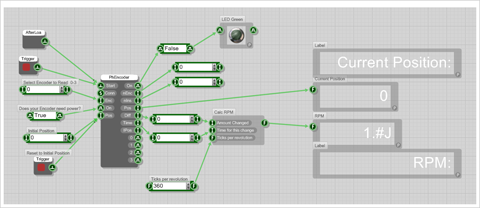

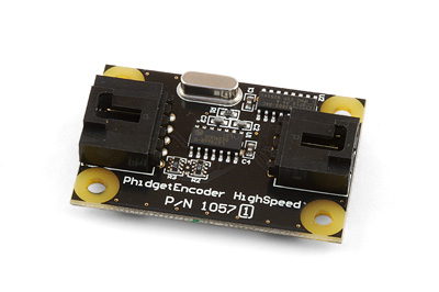

In this example we show how to interface to the Phidgets Encoder. Usually the encoder will be a quadrature shaft encoder with so many 'ticks' per revolution. The Phidgets Encoder counts these ticks and also measures the time between them therefore it is possible to determine not only a precise shaft position but and it's speed in RPM.
Phidgets Encoder clip.png (62.82 KiB) Viewed 46981 times
