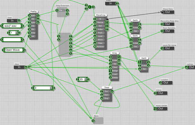

Hi gang,
Not sure why I didn't just post this here sooner - I'm from the OSM days (and still use SM as I have too many half done projects that rely on other OSM's to learn from and... blah - anyway) - I'm wrapping up a new multi-sampler and have just spent the last week banging my head trying to figure out how to add the 'save' function for chosen folders/samples.
So people can simply ::
open their daw,
> open the vst,
> choose a folder of samples, make a song...
> Save/close and reopen their project file in their DAW - and the users samples are now there (where currently you have to reselect samples for every instance of it).
Think I've pretty much read the entire forum front to back now for a ton of keyword searches and tried a good 20+ OSM's to see if anyone has done this yet above and beyond trying to fudge it myself and alter others save commands for other stuff... (I realize there may be differences when loading many instances of the vst and choosing different folder locations for each etc so I'm trying file name saves, folder name saves, and frankly a bunch of stuff outside of my understanding..)
The base multi-sampler I use is the bottom 'multi' one on this page :: http://www.synthmaker.co.uk/dokuwiki/do ... per_player
Link to OSM:: http://www.synthmaker.co.uk/dokuwiki/li ... r_v1.1.osm
I've found instances of this where it will save the file but it's not a multi-sample version and has been tweaked beyond my understanding as well
I'd be willing to pay someone to create a save function for me on the above OSM in the wiki so I can stop trying to figure out one function and keep motoring on the project or if it's literally a 5minute fix and you can get an OSM over to me I'm willing to come over and cook you breakfast tomorrow
Or if someone has already done this or has an existing OSM they can point me to it would be greatly appreciated - I'd imagine I'm not the first that has noticed this in their DAW and it's limiting both workflow and creativity on re-opened projects having to route everything each time (and I know if I release this again people will complain about it again even though it's free lol).

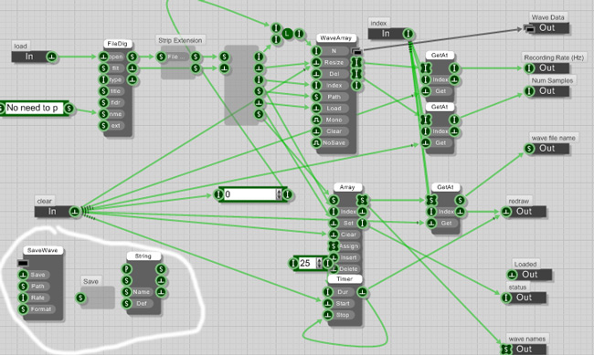

- Inside the save mod - This is from another OSM that seems to save but it's for the single sample instance of the OSM which has a different setup.
- multi-save2.jpg (44.97 KiB) Viewed 37365 times
- Inside the standard WaveLoader that comes in the multi-sampler - notice my little save mod on the bottom. No clue where or how it's supposed to be configured or if it should be one level up?
- multi-save1.jpg (99.62 KiB) Viewed 37365 times

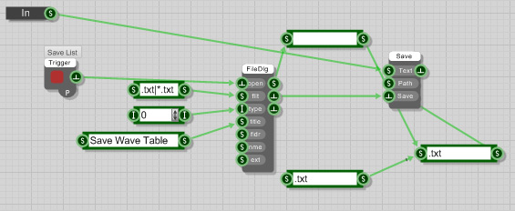

I've made a quick OSM file with a preset manager and all three variations of modules I've tried (shown on the bottom of the jpg attached too) various combinations with - if anyone would be kind enough to tie this together it would be greatly appreciated and I'll show a token of my appreciation to your paypal and hopefully others will benefit from this.
Fingers crossed and thank you in advance!

- multi-save3.jpg (98.66 KiB) Viewed 37342 times
SaveWaveMultiSample.osm- Standard multisampler from exo with preset manager and modules ready to 'save' wave file location - bottom three mods are the things I've tried playing with in many ways but no matter what I connect I don't get the desired result (found inside the wave loader within the player). Closest I've gotten is new samples being added to my existing ones that are IN the .dll but once I reopen a saved file in a host they are gone again.
- (47.52 KiB) Downloaded 1447 times

Well, with a few modifications it's working in here. I used the string preset primitive to both save the path and trigger the sample loading. Formerly the sample loading was triggered by the dialog primitive - I have changed that so the dialog OK "sample and holds" the path that it outputs. That goes to the path/name separator and the path now goes to string preset. Output of string preset then puts the path to the part that loads the samples and also triggers it.
Try it on your machine if it works and let me know.
SaveWaveMultiSample.osm- (47.03 KiB) Downloaded 1493 times
