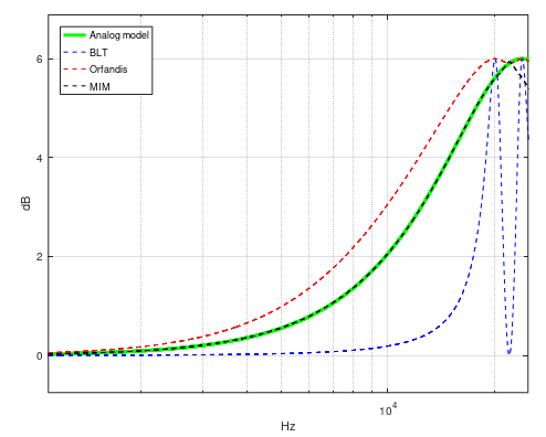

Is there a way to upample a filter so when working on a 44.1 sample rate you can successfully have a peak filter at a higher center frequency higher then cutoff?
For example when working at 44.1, have a peaking filter with a center frequency at 24KHz, that is upsampled then downsample and plotted at sample rate. At 44.1, 24KHz will be over the cutoff (1) and will not work.

Dunno if you can do this well ... though, MIM method works in this well even without up-/down sampling.
