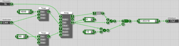

thanks for your advise. Currently im filtering by creating an array for some milli seconds, if it has 10 values stored I calculate the average. Is this a good way to deal with this?

The way you are doing you filtering seems fine... For any of my ADC Systems I try and make the signal input / ADC capture as noise free as possible. But sometimes you still need some filtering.
Here are a few things I use (I grabbed them from a few schematics using ADC / Data Acquisition).
There are both Green and Blue connector versions. Typically the ADC comes in over Green Connections, and I need Blue stream data in the end, so often I will do my filtering with slew limiters or some type of circular buffer or capture XX number of samples and average them, and sometimes I do it with just green connections - just like you have shown.
Hope this helps, and good luck,
Aron
Aron
