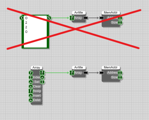

No more crash for now, but i'm a little paranoid after getting so much..
My big error i suppose was to use the text prim to the array to mem.
In my version 3.6 it almost always crash on load, even if i disconnect the text.
With an array prim it's ok.

Hum.. It work better without the text and i also try the mem create.
But whatever i do to transform the address, a crash finish to occur when i load a new address..
It's like some address are not well decoded.
Will investigate more..
Maybe a timer to not load directly the new address, maybe something wrong in the float/int translation..
