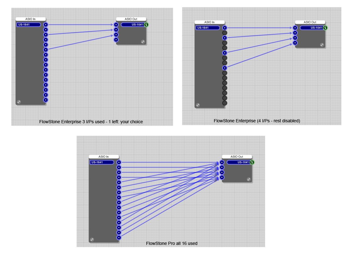

Postby DSP » Sat Jan 29, 2011 12:30 am
A good example of how the ASIO limitations work is to look at a multi channel audio interface like the Tascam US-1641. This has 16 inputs @ 96Khz, in FlowStone Enterprise only 4 will be available at any one time, in FlowStone PRO all 16 are available.
ASIO in FSE explained:
ASIO FES.png (91.23 KiB) Viewed 24817 times
DSP
