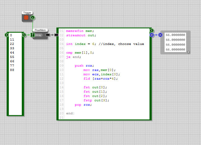

Hey that's interesting. I wonder: is there an advantage over the MemAddress prim? If your new method proves more stable, then I can see some applications like a fast wave reader, fast lookup tables etc. Wonder if this would also work in poly?
Re: obtain pointer to variable in assembler
In the new version this will be very easy to do and it works in poly so you can make fast wave readers.
