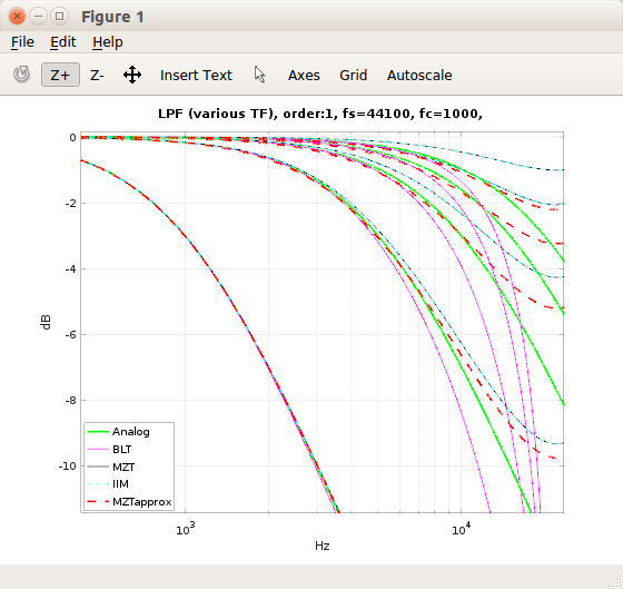

FYI, not long ago I got an idea of trying to speed up MZT/IIM based one pole LPF by using Taylor series to approximate exp() function. After some tryouts I found out that use of just degree 2 polynomial resulted approximation error which actually improved the resposne of the MZT/IIM filters when cut-off frequency was approaching Nyqvist. Not perfect filter but better ... and probably can be improved more but my math skills are not that good... .
So, as winked, coefficients are calculated this way (Matlab/Octave code):
Comparison against MZT, IIM and BLT: https://i.postimg.cc/zDPyPrRz/lpf-robo.png (cut-offs: 1k, 5k, 10k, 15k, 20k)
I also did run speed comparison against the original exp() based filter implementation and got about 20x speed up with this tweak (Ubuntu, g++, --ffast-math enabled).
Octave code for the linked plot image:

This is cool, I'll check it out when I have My computer. Thanks.
