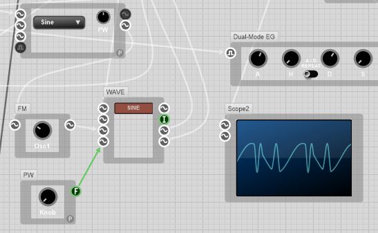

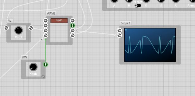

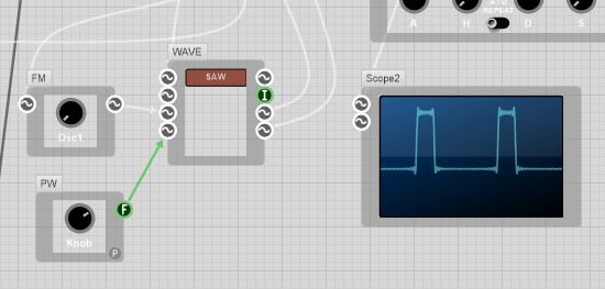

Thanks all for gnawing at this - can't follow the discussion as it's far above my head, but here's the little test schem using the Razorblade osc.
It's interesting that the deep spikes with FM only occur when taking the output from the osc directly. If taken from the output of the stream subtract used to do the PW with a pair of osc, the spikes are gone, but the FM forms flat spots that FM with regular sine oscs doesn't have.
The included iFFT Osc from the Analog Kit has an 'Add Phase' module between the Counter and the Interpolated Read; might be some clues there?
