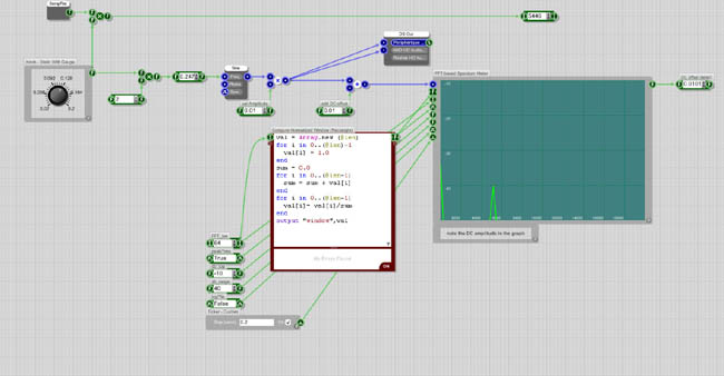

@ MyCo : thanks for pointing this. I have refined the .fsm, including a DC offset management :
- add some DC offset to the signal
- detect the DC offset within the Spectrum Meter (before any windowing)
- carefully observe the DC offset height now showing on the graph : it has a +6dB error
- apply a frequency that's very close to Fs/2 and observe the magnitude on the graph : it has a +6dB error
See the attached .fsm.
It is going to trigger an interesting discussion.
from http://www.dspguide.com/ch8/5.htm
by Stephen W. Smith : "As shown in the figure, the bandwidth can be defined by drawing dividing lines between the samples. For instance, sample number 5 occurs in the band between 4.5 and 5.5; sample number 6 occurs in the band between 5.5 and 6.5, etc. Expressed as a fraction of the total bandwidth, the bandwidth of each sample is 2/N. An exception to this is the samples on each end, which have one-half of this bandwidth. This accounts for the scaling factor between the sinusoidal amplitudes and frequency domain, as well as the additional factor of two needed for the first and last samples.
Many authors do not even include the 2/N scaling factor. Be prepared to find both of these missing in some discussions. They are included here for a tremendously important reason: The most efficient way to calculate the DFT is through the Fast Fourier Transform (FFT) algorithm, presented in Chapter 12. The FFT generates a frequency domain defined according to Eq. 8-2 and 8-3. If you start messing with these normalization factors, your programs containing the FFT are not going to work as expected."
Is Flowstone FFT + MagPhas obeying the standard, regarding the first and last frequency bin magnitudes?
What standard, actually?
Is is recommended to keep the first and last frequency bins "as is" from the FFT algorithm?
Is is recommended to include a correction factor on the first and last frequency bins, in the FFT algorithm, for streamlining the curve plot?
Is there a difference between GraphFF (method 1) and FFT + MagPhas (Method 2)?
What are the choices made by Synthmaker/Flowstone, and why?

- FFT-based Spectrum Meter.jpg (37.39 KiB) Viewed 36480 times

The FFT in FlowStone is just a straight implementation of FFT. It is not different at all. The FFT in GraphFF is just unscaled, because many time you don't need the scaling. eg. when you want to find the peak frequency it doesn't matter how high the peak is, you just need the index of the maximum in the FFT result. Also the Scaling isn't hard to implement, as I demonstrated in the schematic in the other thread. The FFT+magPhase implementation is exactly how you would implement FFT with complexe numbers. The results are correct.
Regarding the first and last bin: The Guide is a little bit confusing at this point.The lines in the plot are drawn between the individual FFT results. That's why the first and last bands are smaller. When you think about that, it is absolutely normal when you draw a graph. The first point is a x coordinate 0, the second at 1, third at 2 and so on, so the first boundary is always at 0.5 while the second boundary is always at 1.5
Unless you want to draw a band amplitude graph (like in a Graphic EQ) you can ignore that. Also for higher FFT-sizes, this doesn't matter because you draw them always as lines.
In your examples you measure the DC offset... with a more excessive code than the one I posted... but you don't remove/reject it. Why? The DC offset can be significant and the FFT is then just displaying wrong data.
