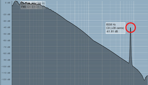

I'm getting a weird problem when using the wavetable oscillator and playing back a saw wave (any wave with many harmonics, would do it too). When I play it very low, so that I get all of the frequencies in the wavetable into the audio band, I get this:
The wavetable I'm using is 2048 samples long, and the osc is playing at 8.1758 Hz. The weird peak you see there is exactly at the nyquist frequency of the wavetable wave (ignore the cursor tooltip in the image):
(2048 / 2) * 8.1758Hz = 8372.0192Hz
Any idea, why this happens? And how do I get rid of that. When you compare it with other synths you can clearly hear a difference...

There is nothing special to it. It's just a normal create wavetable / read wavetable schematic.
Haven't found any FFT inside FlowStone that can meassure the problem. But it's there and with FFT Plugins you can see it pretty well. I use for example MAnalyzer: http://www.meldaproduction.com/plugins/ ... =MAnalyzer

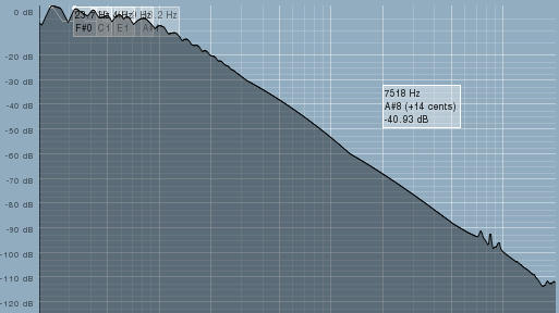

I found a workaround but I'm not sure why this fixes the problem (And it's not a good solution): I remove the top frequencies of the orignal wavetable input array (2048 samples FFT -> zero 200 samples in the middle to remove high frequencies (with a smooth slope) -> iFFT -> wave table)

Here is the workaround, that I described above. It looks like that:

I see it too, with meters in FS. The wavetable osc in FS works in a way, that it creates a list of wavetables. Each wavetable has one less higher harmonic then previous one, second to last has only the base frequency and the last one is silence (used when you input frequency above Nyquist into the oscillator). The osc simply picks the wavetable which will not cause aliasing but still contains the most frequencies.
Only aliasing can be caused by linear interpolation in the osc module, but why it would specifically lie at nyquist frequency is a mystery to me. However, it is not hard to imagine, that lower the frequency the more pronounced will the distortions of linear interpolation will be...
EDIT: it is the linear interpolation causing havoc. When it interpolates it creates harmonics that are multiples of Nyquist. I have found another harmonic exactly at 2*nyqist of the wavetable and 3*N as well.

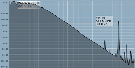

It's not related to interpolation, I've decoded the wavetable primitive's code and changed interpolation to B-Spline, Hermite, Lagrange... doesn't matter. It affects only the smaller distortions around that peak but not the peak itself. I'll make a cleaner schematic of my tests.

Ok, here my tests with different interpolations. The problem is the same. The first spectrum image that I posted was infact from the b-spline interpolation, as this cleans out the surrounding interpolation noise.
This is how it looks like with standard linear interpolation
